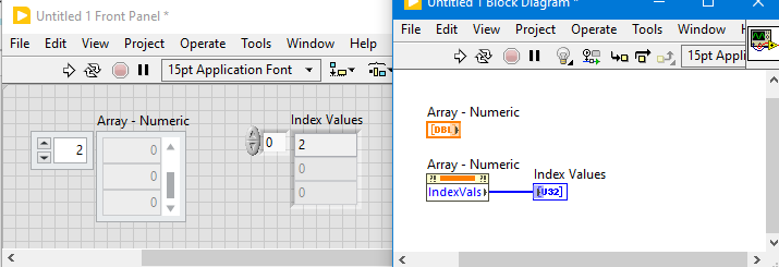

You mean like this?

@jcannon wrote:
Hi all,
I have a 1D array indicator on my front panel and I need to read the index display value...
I don't want to read the array value at that index... I want to read the index location that the user selects on the front panel using the up and down arrows...
I hope this makes sense... I can't find a property node that will read that value...
Any suggestions?
Jack
Use the Property node `IndexVals`
Note that the output is an array with one element per dimension, for example for a 2D array it will return the indices of the element shown in the top-left corner.
