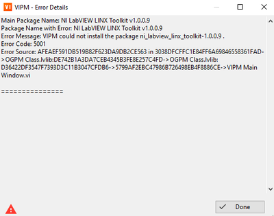

What exactly do I need to download?
When I search NI Labview LINX I follow the path below and I get an error.
11
I also enter the required IP, nickname and password for the connection and SSH settings done on Raspberry.
Thank you for responding.

Accepted by topic author yardimcioyuncu
i am running LV2020 and am able to install that NI LabVIEW LINX Toolkit Version 1.0.0.9.
Try to see what are the error details. also unninstall the digilent LINX first to avoid any conflict
Is SSH enabled on the RPi? you must mannually enable that

I made the SSH settings on the RPi. I can access the RPi interface with Putty and VNCViewer.
and error details
I am now able to download NI Labview LINX on a computer with Labview 2020 installed and it is now installing. Thank you so much
