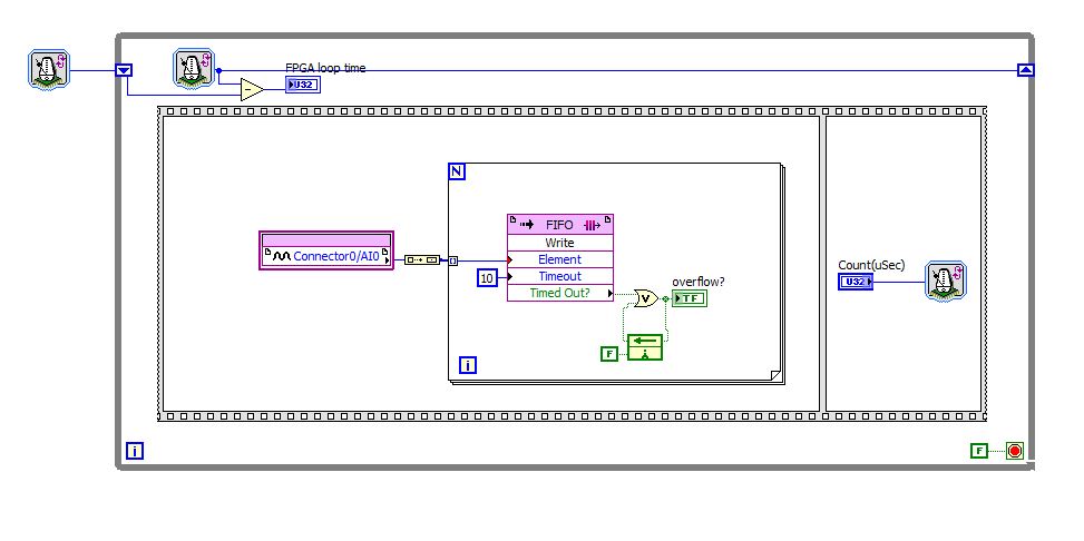

I am trying to use my RIO FPGAs and DMAS, FIFOs etc to read some analog inputs and log the data in a tdms file. I have followed a basic labview example yet my code is not working as it should; on clicking 'run' an error (61003) is obtained from the fifo read and the program stops. Can anyone see an obvious reason why?
The FPGA Code:
and the RT code

It's worth checking that your FPGA reference isn't set to 'Open and Run' instead of just 'Open, since when you reach the 'Run' node in your code it would return error 61003 as your have described.
It's also worth recompiling your FPGA VI just to make sure nothing is corrupted there.

The error code relates to already having the FPGA reference open, so somewhere along the lines it's getting opened twice (attempted).
To be certain:
1) 'Run the FPGA VI' is unticked on 'Configure FPGA VI reference'
2) 'Run when opened' is unticked on the FPGA VI properties, under the category execution.
3) Have you tried enabling 'Wait until done' (T) on the Run node?
4) Alternatively try removing the Run node, since the error implies that it's already running.
As an aside I notice you're also missing FIFO.Stop from the DMA FIFO example.

thanks a lot. with the above things I finaly was able to get it all to work as it should!
