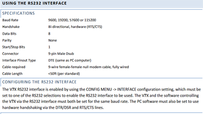

Device Specs:
Baud Rate 9600, 19200, 57600 or 115200
Handshake Bi-directional, hardware (RTS/CTS)
Data Bits 8
Parity None
Start/Stop Bits 1
Connector 9-pin Male Dsub
Interface Pinout Type DTE (same as PC computer)
Cable required 9-wire female-female null modem cable, fully wired
Cable Length <50ft (per standard)

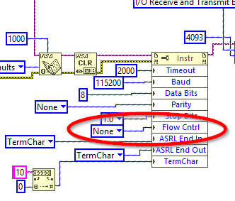

Since it seems like the device is responding to carriage returns, then it appears it's getting info into the internal buffer but just not sending it. Which sounds like a flow control problem to me.
From the user manual, it should default to RTS/CTS flow control by default:
Your code doesn't enable flow control, so I'd guess you somehow disabled flow control on one unit and not the other. Either enable flow control in your LV program, or disable it on the device (not sure if you can or not).
Also, the manufacturer has LabVIEW drivers on their website- have you tried those? (not that mfg. drivers are usually all that helpful... lol)

Just saw in your top post you did specify the settings, but look at this selection here:
Change it to this:
Message 8 of 9
