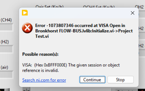

I have Bronkhorst flow meters in my lab. I'm trying to write a LabVIEW program to control and measure flow rates. I've used the example on Bronkhorst's website. I'm sending you a picture showing how I connected it. When I run the program, I always get the problem shown in the picture. When I connect the flow meters to the computer, the problem doesn't appear and the program runs normally. Can anyone help me overcome this problem when the meters aren't connected? I also want to have a condition for the velocity to increase automatically once I specify the step and time. I used Shift Registers, but in this case, the final version result is only displayed when the program is stopped. I want to see how the velocity increases based on the step, not just the final result. Please help. I'm attaching the pictures for clarity.CH4 Bron.pngProblem.pngAutomatically increase velocity.png
You want to communicate "error free" even when there is no device connected to communicate with?
How should that work?

Thank you for your response. In our lab, we have LabView software that does not show this error even if the flow meters are not connected to the computer.
In the VI in question go to File->VI Properties, then select the Execution category, then deselect the Enable automatic error handling.
Or wire those error clusters properly from one VI to the next!
By default, Automatic Error handling is enabled in new VIs and whenever a function returns an error in an error cluster that is not wired to anything, LabVIEW catches that error and displays a dialog.

The error is no longer appearing, thank you very much.
