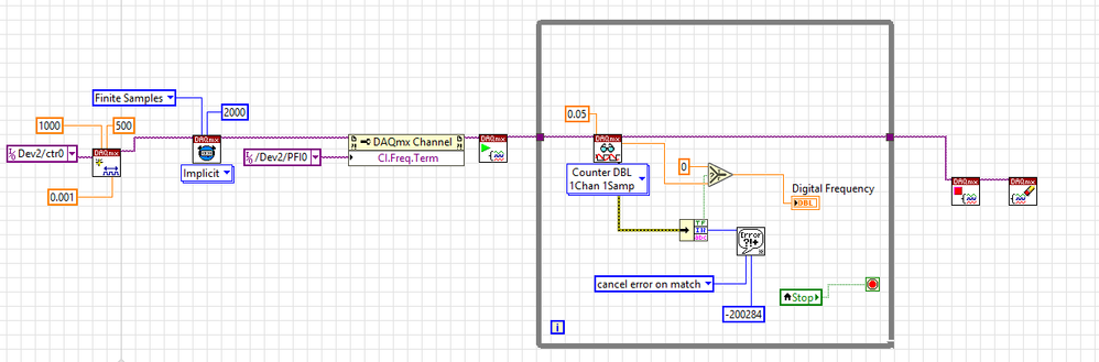

Hi All,
I've searched the forums and found some useful threads but I can't figure out how to apply them to my problem. I'm trying to read pulse outputs from several flowmeters, but my DAQ only has two counters and I'm using them to control pumps. I'm unable to obtain more hardware, so I am trying to measure the pulse frequency using the analog inputs on the DAQ. The code works, but I can only obtain a resolution of 10Hz compared to the digital counter input which measures the frequency to several digits of precision.
Analog Freq 2.pngThe first while loop is just a digital counter task recording the pulse frequency so I can compare it. The second while loop reads 100 analog voltage samples and an internal for loop checks each sample to see the voltage has changed from the previous iteration. If the voltage is now greater than 0.5V there is a positive edge and the 'Pulse Count' increases, otherwise it stays the same. The - || > 0.5 bit just stops small fluctuations from being counted. The count is then divided by 0.05s (the sample collection time) to calculate the frequency. The digital and analog readings are similar, but the digital one is always higher resolution, i.e. 138.57Hz digital and 140Hz analog. Can anyone tell me how I can improve the resolution?

The only way to increase your frequency resolution is to sample for a longer period of time. Your pulse count is an integer which you divide by the sampling interval of 0.05 seconds, which is the same as multiplying the pulse count by 20 Hz. That is, each pulse you count adds 20 Hz to the frequency count. With a longer sampling interval you'd get finer resolution: 0.1 s would give 10 Hz resolution, 0.5 s would give 2 Hz, etc.
One thing that I noticed is that you could get rid of the "not equal" comparison between the current and previous values in your For loop, since that will always be true if the other comparison is true (that is, if the difference between them is greater than 0.5). If the current and previous readings differ by more than 0.5 the signal has either risen or fallen between the two samples being taken, then if the current reading is greater than 0.5 you increment the pulse count. I don't know what your incoming signal looks like, but if it rises or falls slowly enough and remains above 0.5 that whole time, you'll continuously increment the pulse counter as long as it continues to rise or fall.

For measuring the pulse count and frequency, look on the Signal Processing->Wfm Measurement palette.  There are several VIs here that will simplify your code.

Thank you both for your help! The 'Pulse Measurements.vi' seemed to do the trick once I played around with it. It gives me an error when the flowmeter isn't running but I've just added an error handler to ignore it.
