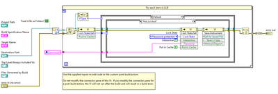

I built the LLB as a source distribution from a project (Destination type = LLB) with the following settings:
I verified this on a few different malleable VIs across a few source distributions in different projects.  Seems to be pretty constant behavior.  My only workaround so far has just been to separate the malleables into a separate folder and just distribute them as bare VI files instead of being built into the LLB.

I couldn't reproduce my issue with a toy project / LLB / caller setup either, so I tracked the issue down in our normal production spot to the standard Post-build action VI we used to password protect items in the LLB.  Apparently this is not compatible with VIMs.
Even when it does not load when you try to drop it in a block diagram, it will still allow you to open it from the LLB and view the front panel, run it, and even enter the password to view the backpanel.  But it won't allow you to drop the item into the backpanel of a caller VI.  I guess this is a known behavior of malleables:
https://forums.ni.com/t5/LabVIEW/Malleable-VIs-Password-Protection-amp-LV-Upgrades/td-p/3936669

The code explicitly breaks password protected malleable VIs. I'm still looking into why. Also if they break when password protected, why do we allow them to be password protected? Might be better for setting a password to fail rather than creating an unusable file.
I'll try to come up with an explanation but for now you should definitely not put passwords on malleable VIs.
Just to clarify, you are saying that you were able to reproduce the issue presented by my little password protecting code that I screenshot?  If so, I apologize as I should have uploaded the VI or snippet so you didn't have to duplicate the code.
If it is truly malleable VIs, and not inline VIs, then a possible workaround for me would be to skip files based on the *.vim extension, but I'm not sure (haven't used a non-malleable inline yet).
