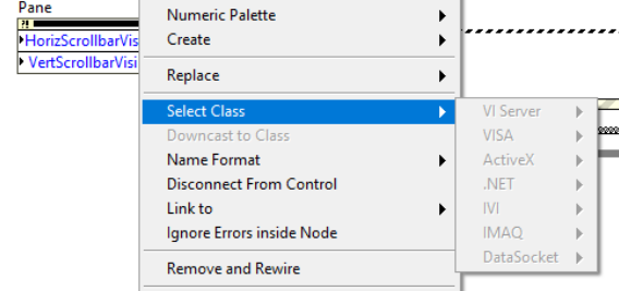

Property node classes are greyed out
In LabVIEW 19, when I try to Select Class of a property node, all of the options are greyed out.  Any ideas why?  Thanks for any help!

I think you need to disconnect from the control first, and then you can select a new class.
(2,785 Views)
Thanks Kyle.  That allowed me to select those options.
