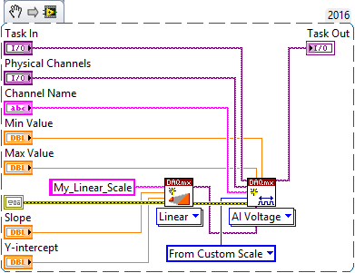

I haven't done this for Polynomial Scales, but have done it for Linear Scales, where you know the (forward) Slope and Y-Intercept.  You use the DAQmx Create Scale function to create your Scale (you'd choose Polynomial, rather than Linear), and wire this into your DAQmx Create Channel function, as shown in this Snippet (I wired Controls to most of the Inputs for mnemonic purposes):
As to why you need Forward and Reverse coefficients, I'm not 100% certain, but DAQmx seems to need to map both ways.  Note that if you have the Forward Coefficient, DAQmx provides you a function to invert the matrix to get the Reverse Coefficients.
