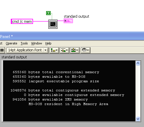

I just thought - if the OP's application is truly a console ap, wouldn't it report back to the console? And all that would be required is something like this? (where "mem" = the 3rd party command line with all arguments).
Richard
