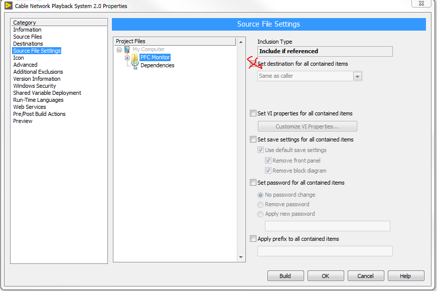

I have never ran into this one before. My program runs fine when I launch it in the LabVIEW development environment. But once I compile it the executable does not run, it launches and immediately closes. I can see the LabVIEW icon pop up on the taskbar for a second then it goes away and the program itself never actually opens.
No error messages are displayed from LabVIEW or Windows.
This occurs on more than one target machine and my development computer.
I don't even know how to begin troubleshooting this besides trying to rebuild which I have...

Would your executable exit if an error occurred pretty far upstream? Could it be something like looking for some dependency (file, drivers, etc.) when the application starts up and then exiting if there is an error?

I would start by disabling (using the diagram disable structure) everything in the Timeout case of your GUI loop. It looks like that is the only code that is executing. Maybe its something to do with your typedef.

Try to clean the build and do do a close all save all this project before rebuilding.
Are the projects dependancies flossed? Project item all in the project and only toolkits, user.lib and vi lib in dependancies?
Auto pop folders with unused broken code?
Do you separate obj from code? If so clear the cache and mass compile.

Well taking Jeff's advice and combing through the project I compared this versions build specifications with a previous one and found one little difference...
The "Set destination for all contained items" box was checked, unchecking it fixed it.
