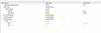

This doesn't seem like a solution at all.  I don't want my VI to have a default value - uninitialized/unconnected (or an empty array) should be a perfectly valid default, and I should not have to set another one just to satisfy the unit test framework.
What'd driving me bananas is the UI makes it look like it should work.  For the inputs in question, I see what looks like an array.  I can resize the array to 1.  In some cases, though, I can set values; in other cases I can't.  I can't figure out what is going on.
Look at the attached example.  Tags and IntValues are both basically the same ... well, one is an array of cluster (string,string) and the other is an array of cluster (string, int).  I can set one but not the other - with no setup vi required.
It's just remarkably inconsistent .... why?
