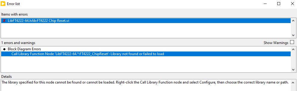

The problem I see when I try to open the VIs generated by the import is "Library not found or failed to load":

Well that error message usually indicates that the path to the DLL is incorrect.  If that's the case, you have two options.  Either open the DLL configuration and browse to it, or set the DLL node to use a dynamic path and wire the DLL as a path to the VI.
However, it could also be a bitness issue.  It could be that a you're using 32 bit LabVIEW to call a 64 bit DLL, or vice versa.  The name of the DLL does imply that it's 64-bit.

The import wizard sets up the call with the DLL path, with a wildcard:
C:\Program Files\National Instruments\LabVIEW 2021\user.lib\LibFT4222-64\LibFT4222-64.*
Browsing to the DLL does not change the error message.
C:\Program Files\National Instruments\LabVIEW 2021\user.lib\LibFT4222-64\LibFT4222-64.dll
I am not convinced that using a dynamic path will make any difference. I am inclined to think it will just change the point at which the error is reported (at runtime).
I might try that if all else fails, but I have never had to do it that way before.
You are right about using a 64-bit DLL. I am trying to run it on 64-bit LabVIEW, so that should be OK.

Did you really install it or just copy it into that location? That is not the same at all. DLLs are compiled with a compiler and compilers tend to require runtime libraries. These runtime libraries tend to be compiler version specific and unless they are explicitly linked into the DLL (which is not the default and makes them larger), this runtime library needs to be installed on your system. And yes I mean installed, copying some extra files is usually not enough as it is not trivial to track down all the possible dependencies and they may vary depending on the OS version you want to use them on.
