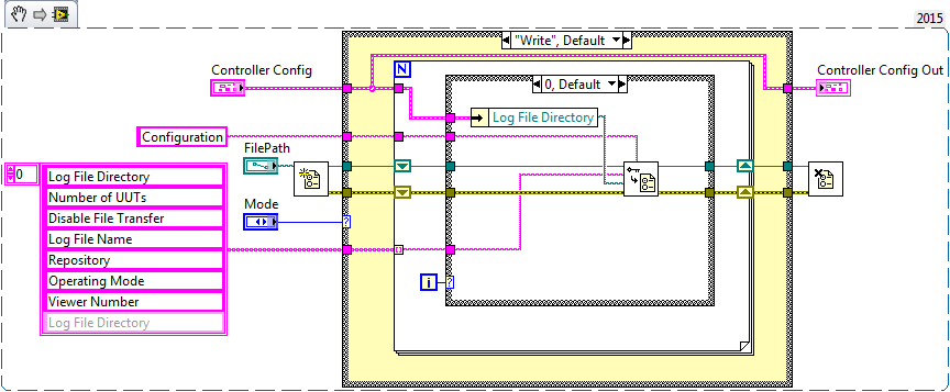

The attached vi works as shown. Why does it not write the data to the file if I remove the 'wait 1 milisecond' code? The section and keys already exist in the file but only get overwritten if I wait a millisecond on every loop iteration. LabVIEW 2015 (15.0.1). I tried changing the config file reference wire to use a shift register.

I removed the wait and it works fine for me.  Do you have something acting in parallel with this code that could be messing something up?

That's an interesting question/observation.  I'm more taken with the fact that you do not use the Refnum Out terminal of the Write (or Read) Key function to an Output Tunnel, and use that to Close Config Data.  Data Flow is a funny thing, and you might have run into an interesting LabVIEW Compiler Optimization that has messed you up.
I've taken the liberty of putting both the Refnum and Error Line in shift registers (the Error Line is there for a reason -- use it!) and I removed the Wait.  Does this work the way you expect?  [If it still fails, this should be brought to NI's attention].

Thanks, Bob for your suggestion. I gave it a try and still have the problem. I did think about data flow, and am convinced that what I had should work (at least from the data flow perspective). I know the underlying architecture of the config file VIs uses queues. This suggests that there may be asychronous activity.

PEBKAC error. Problem Exists Between Keyboard And Chair. I had another piece of code running in parallel, also writing to the config file. Problem fixed. Case closed.

Ah, so my first reply was correct!
