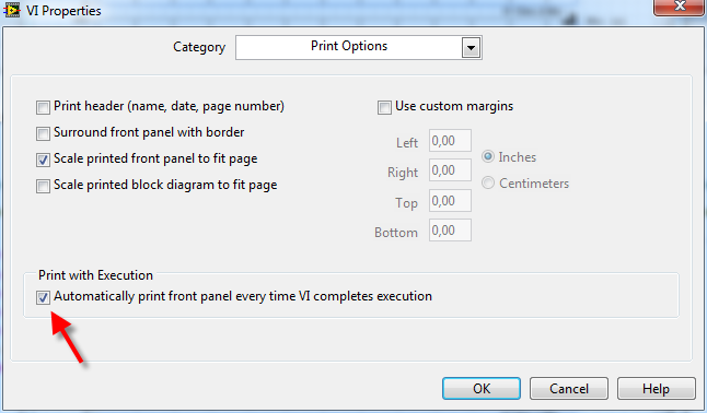

i want to print the FP of a VI multiple times and generate a PDF document.
Before:
i have used the following options.
VI Properties >> Print Options >> Print with Execution     => this creates 3 pdf documents (on printing 3 times) instead of one.
VI Properties >> Print Options >> Scale printed front panel to fit page.     => this option scales the FP to fit the page.
with these options the FP image really fits on the page.
Now:
i need a single PDF document with all the 3 pages.

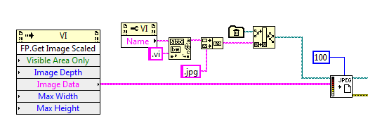

Problem: If i use Append image to report VI, then i cannot scale the image on the page.
by saving the image to disk and then appending it to a standard report, the Image is not really fitted with the page in the PDF.

i'm attaching an example vi which uses the method 'Print. Panel To Printer' and the created pdf. see page3.pdf. The quality of the pdf is really good.
PanelPrint.vi prints a page each time it executes. i need a single pdf (or single print job) with multiple pages.
but if i am using the report generation VIs, i am appending images to report and not getting the desired quality.
any suggestions??
