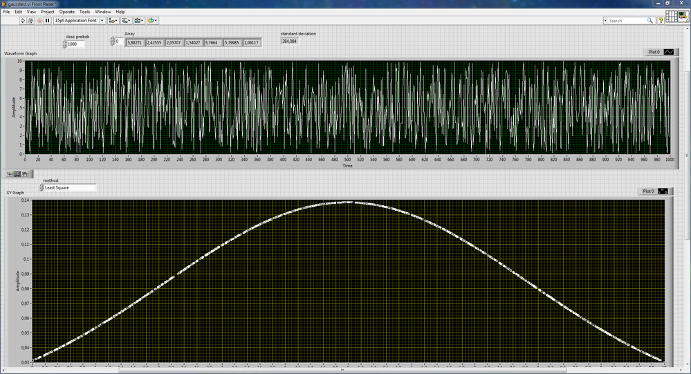

I have a problem concerning the visualization of the probability density distribution. I managed to make a distribution (vide gausstest.vi file) and it seems ok, but the XY graph shows it in a way, I don’t like 🙂  I tried to compare the options of the XY graph with the one used in the Labview example- Display Continuous Probability Density Function but I didn’t find any solutions.
I bet it’s simple, but I don’t know Labview that much yet, I’m a self-learner.
I would like to ask you how/what to change in my .vi so the XY Graph shows only one curve describing the normal distribution (in a standard way, to see the Gauss curve only, not the connections inside the Gauss curve between all the points).

Nevermind, I solved it ;] I just had to sort the input array ;]

you need to right click on the plot in the legend and select Common Plots -> Points.
Here is a screen shot:
After that operation your front panel looks liek this:
