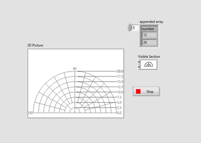

Hi there,
I was trying to simulate a radar in LABView using Polar Plot. I coded it as the images below. The program is running without informing any errors but it did not appear anything in the chart.
Could you please show me the reasons?
Thank you!

Hi Alex,
The plot needs at least 2 points to create a line and you are giving only 1 data point.
Extend the "build array.vi". Connect the appended array to the right of the while loop, right click on the terminal which will appear and create a shift register. Then connect the left shift register to the "build array.vi". And initialise the shift register.
On a side note : you may prefer to use "bundle by name" instead of "bundle" for the plot attributes. And also put the property node outside of the loop as it needs to be read only once.

Thank you bro,
Thats right. I can plot the graph now. I am very appreciated!
