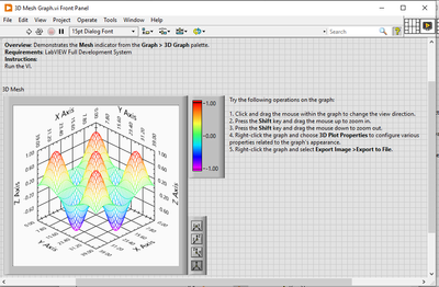

Labview does not have a "joystick" type so you need to improvise, one solution would be to use a Horizontal Slide and a Vertical Slide, as Integer and move from 0 to 2 to act as imput for x aFor the 3D labVIEW has something called 3D surface , check the Examples for 3D.

Here's an Input and an Output question for you.  You are scanning in the XY plane, and getting 4 "wavelength" channels of information back, which you describe as a "pixel".  Is it your goal to "paint a picture" where the 4 (8-bit?) Pixel data get represented by a 32-bit "color" setting, or do you want 4 3-D graphs of "image intensity at XX nm wavelength" for the 4 wavelength channels?  The first you'd do as a "Picture", the second as 4 3D graphs.
