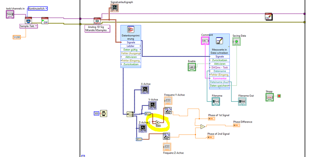

for an experiment I use an accelerometer which records the accelerations in three spatial directions. From two of these axes I get a sinusoidal signal. I want to determine the phase offset of the two signals. The signals have different frequencies, which are a multiple of each other. For example: Signal 1 = 20Hz; Signal 2 = 40Hz.
I have created the VI according to a similar instruction from the forum. The circuit works for the same frequencies for signal 1 and signal 2, but not for different frequencies.

I am not sure if I understood your solution correctly. I have now multiplied the signal 1 (20Hz) by itself. What do you meant by removing mean? Do I still have to derive my sinus signal for your solution into a cos function?
A new image is attached, with this adjustment I get a stable phase shift (the phase shift does not jump now like before), but it does not match the real value. Do you have an idea where my error lies?
vi is also attached.

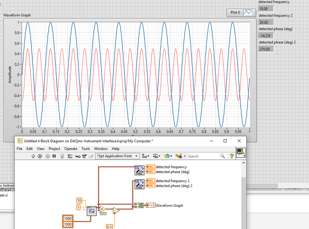

Look at some math identities;  whenever you multiply sines and cosines you get sum and difference frequencies. So if we multiply a sine by itself the sum would be f+f, the difference f-f, so a DC signal also. You are using a FFT to measure phase so not an issue here.
Understand how your functions are working; see the example I sent; there is a -90(270) phase shift when squaring the signal. (See below)

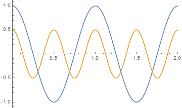

For example assume you use a SIN wave as your reference. You square the signal to get the 2nd harmonic. The signal looks like this(I subtracted the DC part)
Sin(blue), Sin^2(Orange)Sin(blue), Sin^2(Orange)
Like the example I showed earlier there is a phase shift between the two. Why, because
Sin^2(2 pi f t) = 1/2(1 - Cos(2*(2 pi f t) ) )
Notice how the sin went to cos and a negative amplitude, this means a -90(270) degree shift; just like in the example I posted earlier.
