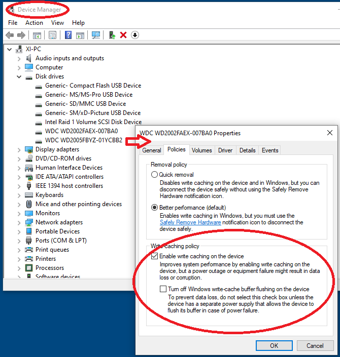

@Ken_Brooks wrote:
  • Did you disable write caching?
  • -- I don't even know how I would do that. Is that a LabVIEW thing or a Windows thing?
It's a windows thing and I really don't know what depends on it. Never tried without.
You do it from the disk drive properties in the device manager:
Message 8 of 16
