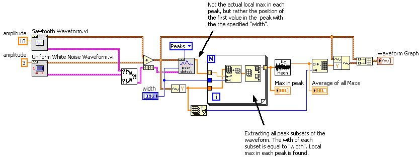

Since you are looking for only measuring the average of the peaks and not the whole waveform I will recommend using the "Waveform Peak Detection.vi" (not in LabVIEW Base) to first extract the peaks. You can thereafter take the average of all the maximum values from within each peak.
The "Waveform Peak Detection.vi" is not the easiest VI to use, so the best way to learn its functionality, is to play with an example. Therefore I have created an example that extracts all local maxima of the peaks in the waveform and averages these maxima.
In case this example doesn't cover what you are looking for, please refer to the shipping example called "Pulse and Transition Measurements.vi" and let me know if this is closer to what you want. Also, please read this online tutorial that describes different peak detection techniques:

Hi all,
I noticed you created a waveform. but I tried using your example vi to detect average peaks from a DAQ AI and it doesn't seem to be working for me.  I'm using USB 6212 daq board and LV 7.1.
My continuous AI signal is not exactly a set frequency and it is not repeating so I can detect the peak values but I can't seem to take the average of the last 3 or 4 peaks.  I like to just display avg numberical value of the last 3 peaks.
When I use a shift register to hold the previous N-1 values they cannot be displayed forever because of my buffer size.
Thanks!
