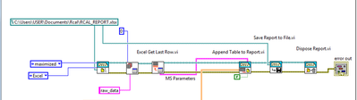

I have an EXE(and Source code) that updates a report everything is run, the EXE works great on my PC but when I move the  EXE to the machines it was made for it works but doesn't update the report i think is a path issue.
I locate the template in the same location for all other machines but i think the issue is the name of the PCs,
Each PC has a different name,PC1, PC2 PC3..
So is there a way or nomenclature in Labview to telling the EXE to go to the Documents file\Report file\Report.
without including the name of the PC ?
Thank you

1. don't use absolute paths.  Use a relative path with respect to the "application directory" / "strip path" / "build path"
2. Check if your target folder exists.  If not, create it.
(1,592 Views)
Accepted by topic author Shawn19
Use can always use Get System Directory function to get the Public Doc or My Doc folder.
