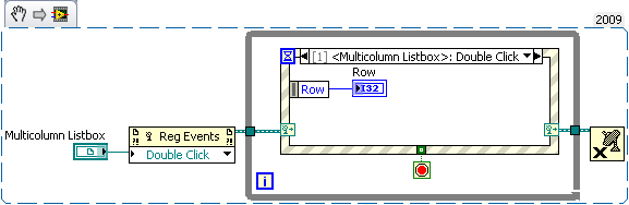

It seems that you already pass a reference to the MC Listbox to the subVI.  You can use that to Dynamically register for the Double-Click event inside the subVI.
Message 8 of 9
(6,007 Views)
Perfect... that's exactly what I was looking to do.
Once I figured out that you gotta plug the reference into the "event" instead of the "event registration refnum" hole, everything worked swimmingly!
