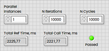

It is quite simple to demonstrate.
I will create a simple "Dummy" VI with the following calculations:
This is how it will be called and benchmarked:
Sometimes I using flag x80, in case if my SubVI configured as preallocated clones, then it looks like shown below, I will open the same number of references as parallel instances, then take one from the "pool" for each call:
This is a typical design patterns for parallel calls by reference (both attached for experiments).
Results:
Single Thread:
Same performance, so far so good,
Two threads:
Roughly half time, works as expected.
Four threads:
In general, it does the job, but a direct call is slightly faster (obviously, becuase inlined) than a call by reference. So, if you can avoid a call by reference, then avoid it. The real problem lies somewhere within NI Math. It could be that some SubVIs are not marked as reentrant (for example, original Quadrature Integrand.vi from Examples - not) or not inlined, or perhaps there is some mixture of calls by reference inside reentrant VIs. Who knows? I usually say that every observed behavior has a rational explanation, but in this particular case, it was much easier to "close eyes" and replace all calls with their content (like "forced inlining") to reduce any possible overhead without deeper investigation. Of course, this resulted in a "spaghetti" VI that now needs to be strongly refactored.
If you need ultimate performance, then in theory, you could recreate all these computations in pure C, compile it with a good compiler, and then call it as a DLL. I expect around a 3x-5x performance boost (at least). However, this would increase the "maintenance cost" of the solution, as you would be mixing two programming languages and adding additional dependencies.
PS
By the way - I forgot to change flag back to x40 in previous benchmark, so the difference is not so dramatically, but anyway faster than original NI math:

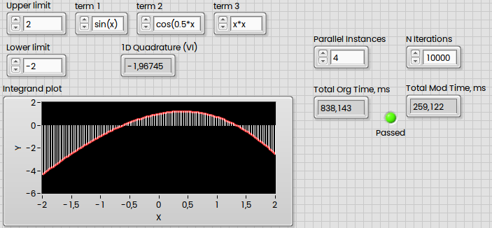

Just one more thing.
I was too pessimistic when I made an estimation of a 3-5 times performance boost after re-implementing this algorithm (which is the Gauss-Lobatto method) in C and compiling it into a DLL
Let check. This is the C code as is

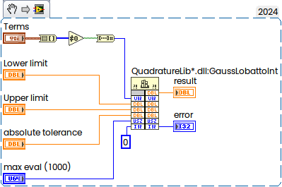

How it used in VI:
And benchmark:
Result on 64bit — 45 times faster:
And the good point is that this approach is much better "suited" for parallelization, for example, for 8 threads:
LabVIEW's code processing time decreased from 2.9 seconds down to 1.2 seconds, while the DLL's time improved from 64 ms to 16 ms, resulting in a 70x faster execution in 8 threads.
The only problem is that it’s hard to get exactly the same result because floating-point arithmetic is not associative in general. I mean, (a + b) + c is not necessarily equal to a + (b + c). Therefore, a direct comparison will not work. However, the proposed algorithm differs from the original by no more than 10⁻¹⁴ to 10⁻¹⁵, which is acceptable in most applications.
For 32-bit systems, the performance boost is not as significant. The DLL is around 20x faster for a single thread and up to 35x faster for 8 threads.
The provided code was compiled with Visual Studio 2022, so to run attached code you might need the latest Microsoft Visual C++ Redistributable if not installed yet.
As you stated in first message above the initial execution time is around 40 seconds, so it makes sense to give a try with DLL, you can get less than second. Also remember that by default LabVIEW will reserve 24 threads per execution system. If you need to utilize all 32 cores from parallel for-loop then you have to perform  "fine tuning" and set thread limits for standard to at least 32 or more, otherwise you will be not able to run more than 24 parallel instances of VI with DLL inside.. Refer to Configuring the Number of Execution Threads Assigned to a LabVIEW Execution System.

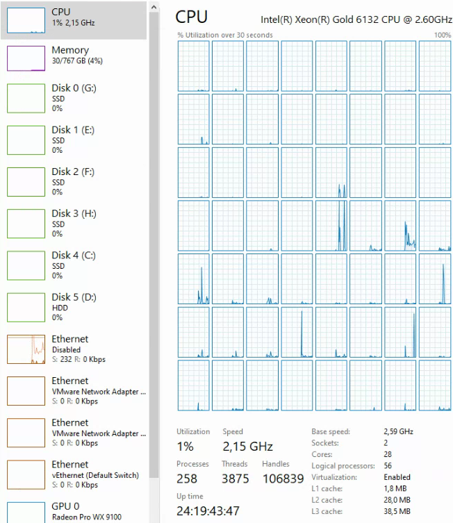

And you will not believe what happened on the high-end machine, like this:
Here with 56 threads speedup by factor 400x:
Well, well, well, the given LabVIEW code was not optimized, there are lot of points of the improvement, but you have no chance to reach same performance.
