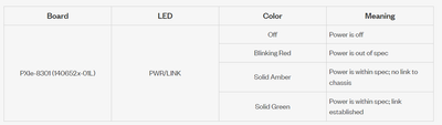

PXIe-8301 not connecting (Solid Amber LED)
I am using a PXIe-8301 which I have plugged into the PXIe-1082 Chassis. However on powering on the Chassis the LED on the PXIe-8301 glows solid Amber which indicates Power Supply is Okay but no link between Controller and Chassis as per the below specification page:
Additionally, my PC did not have a Thunderbolt port so I have installed, Asus Thunderbolt EX4 to my PC to connect to the PXIe Controller and Chassis. Can anyone please help me troubleshoot the problem?
As I can understand there is connection issue between the controller and the Chassis. I have tried restarting the Chassis multiple times however the problem still persists.
