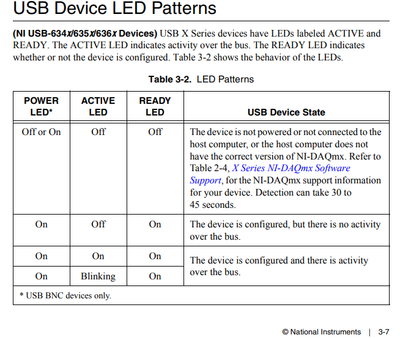

Currently working with a PXIe-6535 board and seeing timing issues every couple seconds. I have also noticed that the "Active" light on the board is amber colored and blinks rapidly (too fast to count) every few seconds, and it appears that these two things (timing issue, "active" blinking) may be happening at the same time.
Any help on this issue would be greatly appreciated, and if anyone knows how the lights on this board work, please let me know!

"Active" light blinking is a good sign, but there is no quantitative link to the functionality of the device.
Can you elaborate more on the "timing" issue you're facing? do you notice the same with NI shipping examples or just your application?

LED info is right in the X Series manual:
You will need to be a LOT more specific about your timing issue to get any help. Sounds like you're overflowing a buffer, but that's just a guess.
If you post the code that is not working properly, we can take a look.
