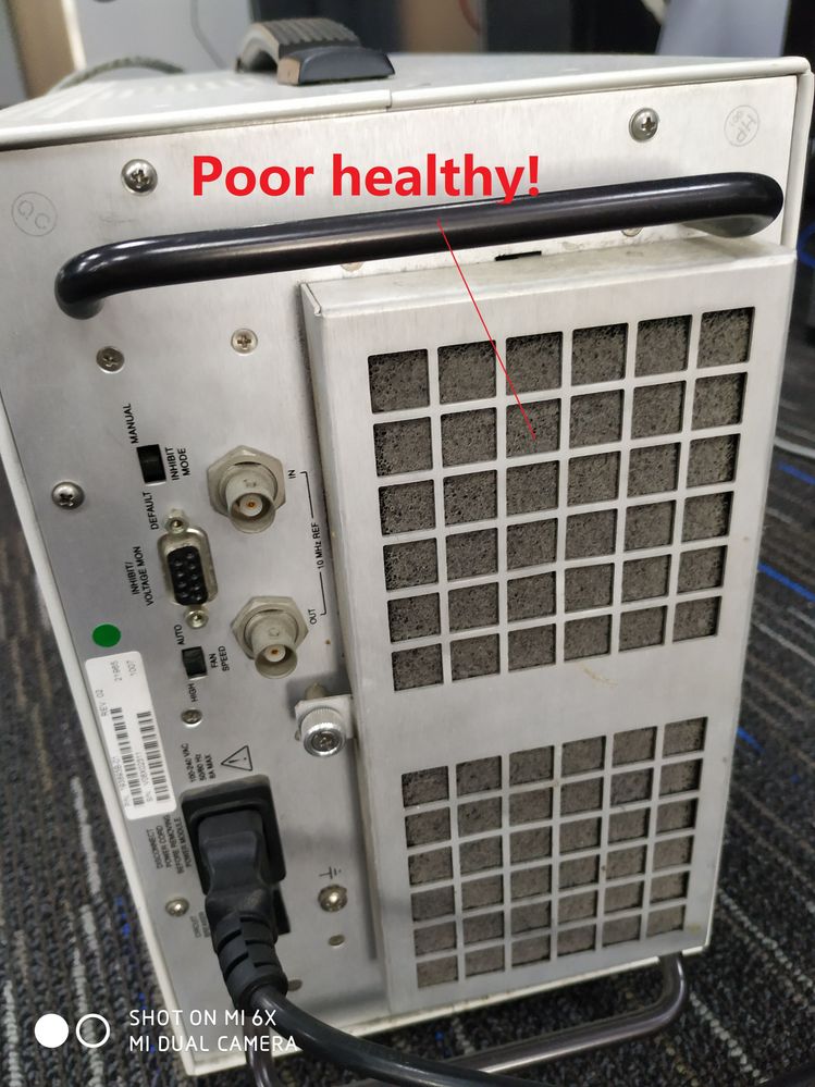

After reading all the descriptions, I think the temperature must be the only change to your system. The whole world is having a very hot summer now.
Referring to the manual, can you confirm if the PXIe-8880 controller is still working under the epxected "Operating Envrionment" (0 - 50 °C)? High temperature will cause CPU frequency variation, this will increase the jitter of the RT.
My suggestion:
1. Ensure the sponge of the chassis is in a healthy state:
2. Ensure the chassis is well sealed in the unused slot:
3. Turn the fans on High.
4. In the BIOS, disable the following CPU configuration which will impact the jitter of the RT: Hyper-Threading, Turbo Boost, C-States, and Intel VT-d.
Hope these will help.
