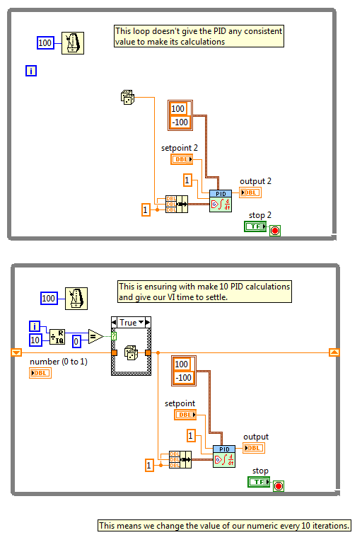

It seems that the issue Mohammed is describing is the following:
The first loop is what Mohammed was describing, where having the Ki value change would result in the output value not responding to changes in the setpoint.  For example if the setpoint is 10, the output is 9, but when changing to 20 the output doesn't change.
To me, this seems to be more of a control theory issue than a problem with the software. If you look inside the PID vi, it compares the PID gains to the previous values, so we need to ensure that the gain values are settled for at least 2 iterations, otherwise the VI will behave as we were seeing.
If we use ensure that the PID gains values are settled for at least 2 iterations, that means the PID VI has 2 iterations to settle on a corresponding output. The second loop uses a random number generator as input for my Ki, but ensures that we conduct 10 PID calculations before we change the gain value.  Certainly, Barp may be able to provide additional input on this.

After this discussion and based on Barp & Tejinder  advice I build my fuzzy logic code in a way that makes the PID VI settled for at least 2 iterations to give the desired output and it works very good and the problem solved, so it was a control problem than a problem with the PID.
I posted my code here so every one can get benefit from it.
