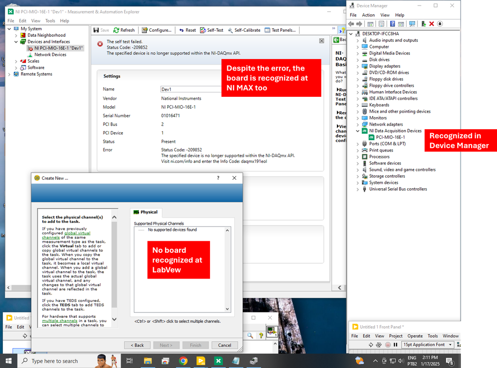

I'm trying to use a legacy PCI-6070E (PCI-MIO-16E-1) board in LabVIEW, however, It do not appears at DAQ Assistant Wizard, as shown by the image attached. Please, help me to setup this board. I've readed a lot of posts here, especially about software and hardware compatibility, but still without resolution.

PCI-6070E is so legacy that no recent OS, driver, or LabVIEW will support it.

Accepted by topic author francois_martins
Devices and Modules No Longer Supported in NI-DAQmx
NI-6070E was last supported in NI-DAQmx 19.0
You would need to uninstall and reinstall LV2019 and NI-DAQmx 19.0
Thanks ZYOng. I stand corrected; indeed it is supported in DAQmx 19.0

Thanks, ZYong!
This LabView and DAQmx works with that legacy board! 👍
