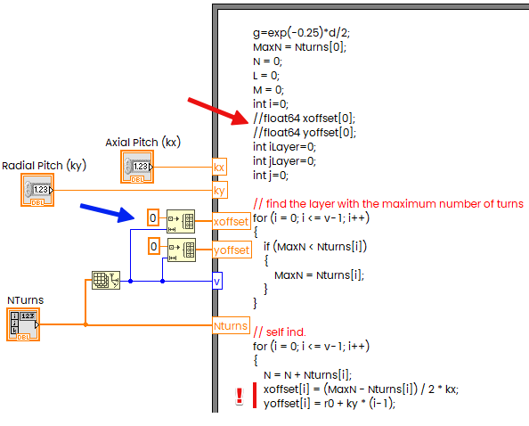

I am trying using attached formula node.
Self inductance works, but mutual inductance has some problem.
Could you please help me?
Message 6 of 17
(1,851 Views)
Accepted by Mal123
Yes, the very first problem you have is with xoffset and yoffset arrays, which are not large enough, then you reading outside of threse arrays and have NaN value as result.
You should modify your code something like that:
By the way, this will also change the Self inductance value, so, I'm unsure that this part works properly in your code.

In my humble opinion your code is still not valid because of this (at least):
There should be no '-1' here; otherwise, you will obtain a negative value during the first iteration (as your BASIC code appears to use 1-based array indexing).
I recommend comparing the results with your BASIC code — given the same input data, the outputs should be nearly identical (accounting for minor discrepancies like machine epsilon).
