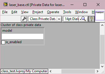

So, I begin by creating a laser_base class. This is the class which will include all the abstract functionality and attributes I want all the laser models to have. It will feature VIs/methods such as fire_laser, stop_laser etc. Let's say it also has an is_enabled boolean attribute, which determines whether the laser is enabled or not.

As you've noticed, I've not yet taken advantage of the is_enabled boolean, and this is where my actual problem arises.
I need to be able to disable/enable all and any future child classes (laser models) methods using the is_enabled boolean in the parent class.
Ideally, setting the is_enabled boolean in the parent class disables all of the VI methods in all subclasses without too much fuss.

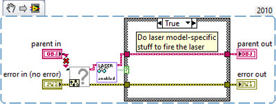

The only way I can think of right now (considering how I chose to structure my code) is to go inside each subclass VI and put all the functionality inside a case structure wired to the is_enabled control so that it is only run if is_enabled is true, like so:
This is the fire_laser VI which I've overridden for laser_type_a. The broken VI is the Call Parent Method VI (which appears normally in my code).
I can also think of no functionality which I can put inside the parent method that can override the subclass VI, since the model-specific functionality will always be called, no matter what the parent does.

Your stuff is broken (missing items, and apparently misnamed items).
Use a property node to access the "enabled" bit instead of calling "Read is_enabled.vi"
