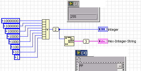

       i want to convert decimal number to hex string.i am using global variable as decimal integer.i want single data from globle variable as a single bit,means 8 globle variable as a 1 byte.
We cannot help you because we don't know what you have and wat you want. Your question is not clear.
What is the datatype of the global variables? If each integer is one bit and you have 8 of those, we need to know how they map to the bits. (e.g. "0,1" for "bit set/not set", resp.).
Then we also need to know whay you mean by "hex string". Is it a hexadecimal formatted string consisting of the letters 0..F, each representing a nibble, or do you want a binary string where 1 byte represents your 8 bits.
One solution might be to make an array of your 8 globals, wire it to a "not equal zero", and then convert the result to a number using "boolean array to number". If you want a bunary string, you would then typecast it to a string. If you want a formatted string, you would use "number to hexadecimal string".
The following code converts 8 "0/1" values to a binary string. Modify as needed.
Message Edited by altenbach on 06-06-2008 12:10 AM
Message 6 of 14
(5,425 Views)
     Thanks it works properly.

     It works but when i connect more than 8 global variable means 9th variable to build array then what happens?

hi,
    when i connect 8 global variable it gives me output in BCD count but if i want 9th variable as a first then what should i do when i resize that array.i am sending u attachment see my logic. consider 8 variable means 1 byte  then from 9th to 16th  2nd byte.is it right ?
