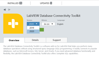

Hello
Whenever i try to install anything from version 2018 or earlier, i have to download it manually from the website, because NI Package Manager doesn't show me an option to download anything other than 2019 and 2020 versions.
I am logged in and have professional license and can download older versions online, but NIPM won't show em.
Am i doing something wrong or is this just the way it is?
Example with database connectivity toolkit:
Message 1 of 11
(4,831 Views)
Accepted by AeroSoul
Hi Soul,
answer: NIPM was started with LV2018 - it simply doesn't know anything before that!
You need to download the installation packages from NI's website for older LabVIEW versions…
