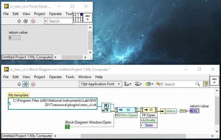

Is there a way to specify the default window size when the "new VI" action is invoked? Both for the block diagram and front panel?
In 99% of cases the front panel is way too large by default. I know I can just resize after, but it's becoming tedious to do.

1. Use template.
2. Create a VI to dynamically call the template.  Save the VI as lv_new_vi.vi at:
C:\Program Files (x86)\National Instruments\LabVIEW 201x\resource\plugins\lv_new_vi.vi
lv_new_vi.vi will be called whenever you create a new VI.

Thanks for the info George.
I've created a template (new_vi.vit) and a VI named lv_new_vi.vi and placed it under the directory mentioned, but it doesn't seem to invoke it when I use File-> New VI or Ctrl+N.
I've restarted LabVIEW as well.
Solved:
The lv_new_vi.vi must have an I32 indicator named "return value" wired to the top right connector.
0 for no error
1 for error
https://lavag.org/topic/11373-lv_new_vivi-conpane/
VI attached (saved for 2009)

Fixed it
0 for no error
1 for error
Thanks!
