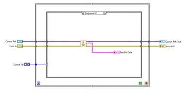

1. My application is working fine with LabVIEW using Network streams for Host and RT
2. After converting to executables, I am not getting any data.
3. If I run the RT using LabVIEW and host with executable I am getting the data.
I cheked the URL name in writer and reader endpoint which is matching. Attched the Ntework stream VIs below for RT and Host.
Any help will be appreciated.

Thanks Bob for the support,
Actually it was not issue with Network Streams. After troubleshooting came to know that, it was the FGV which was causing the problem. I have used property node in FGV which was not working in executable file and working in VI. After updating the FGV, it cleared the issue and was able to read the data from RT to Host.
I am posting here, hope it helps someone.
