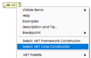

Then, if we talking about very recent versions (Bouncy Castle C# .NET release for .NET 6.0 & LabVIEW 2024) you can select .net Core Constructor:
Then select BouncyCastle.Cryptography.dll and choose appropriate constructor:
Follow Bouncy Castle doc from this point, but take a note that .NET Core support added to the latest LV is "experimental", could have some issues.
Refer to the Help Using .NET with LabVIEW and examples located in "<LabVIEW>\examples\Connectivity\Dot NET" and "examples\Connectivity\Dot NET Core" folders as "getting started".
