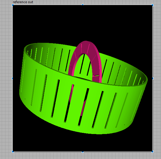

Pls find the attached image file.We would like to do the below mentioned Cockpit GUI window for our MRU value's mapping (roll,pitch,heave and heading) in LabVIEW.Is there any developed Cockpit window in LabVIEW available or else guide us to do the same.

Dear sir - With reference to the above artificial horizon application , we want to add the arrow mark that needs to points the heading value. If we create the arrow mark in .jpg / .stl file and when we add the same into the above horizon 3d object, the inner roll and pitch image has vanished. We couldn't able to add the more pictures into that as per our customized requirement. It would be very great , if you can guide us to accomplish this task. Please do the needful.

Show your code and .stl

Jayanthi.
first of all you need to study 3D.
This is your objects. Call AutoFocus method and you'll see it.
and here you add new object to scene 100 times per second. What for?
