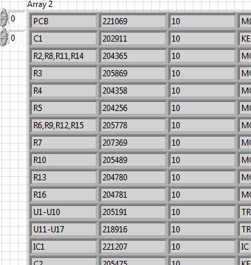

Until now this was just an 1D array I worked with. Actually it's a 2D array I read from a .CSV file:
As you can see there are some places where stuff is combined with either - or comma. I need to expand the first column as described above and as solved in the thread I mentioned. Done! No problem. I extract the first column into and 1D array. Then I expand it. Now I need to put it back into the original array and also expand the whole thing.

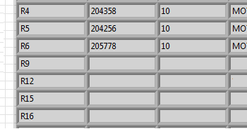

It should then look something like this:
Then I only need to copy the line from the R6 position and paste it into the blank fields:
