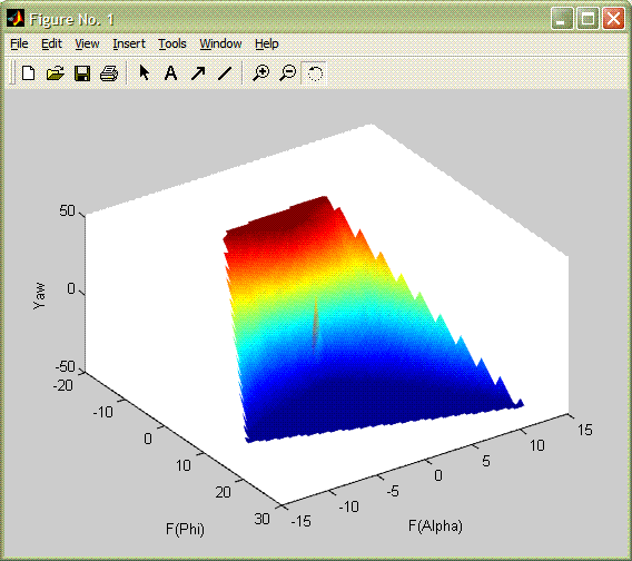

Hi altenbach,
I have checked again. Tried increasing the precision of values in all arrays up to 8 digits, however, I guess I am only changing the viewing resolutionSmiley Surprised. Does the code calculate the polynomials with a similar resolution?
Also, if you compare the surface obtained by the LabView code with that of Matlab, it is quite clear that there is some error, and the X-Y pair does not have duplicate Z values Smiley Sad. I am attaching screen shots of the two surfaces obtained in Matlab.
Hope this helps in ascertaining the root of the problem.Smiley Indifferent

I am not familiar with the guts of the griddata function, but I think it is safe to assume that it does NOT fit to polynomials, but just does some local triangulation. Not sure about that, though.
Unfortunately, your data in the m file has a weird mix of spaces and tabs as seperators, but once it is cleaned up, it seems to fit quite well with a 3rd or 4th order polynomial using my old code.
See attached. There are a few outliers (e.g. phi~30) but you could change the axes for a tighter range

Hi again,
Further to my previous post, I tried substituting the appropriate coefficients into the code. However, just like in earlier versions, the 3-d plot apparently shows multiple z for same xy pairs (at least that is what it looks like, however it could be false if watched closely). Also, if the same set of values were plotted in Matlab, the attitude of the surface would follow the direction as indicated by the red arrow in the enclosed image. Please comment.
On the other hand, the surface obtained with poly order of 3 with 3DPoly_Newdata.llb as you had suggested in your post dated 09-11-2007 11:19 AM is the same as that obtained if matching axes are plotted in the last successful version 3DPolyFitFULL3D_select3.llb
Have I gone wrong in assessing the code?
ViHAR.

Well, I don't really know what you are saying. You can name the data anything you want, and it won't affect the outcome. I named it alpha short for f(alpha). You can easily change the names for the data by changing a few labels and diagram constants.
I plotted (and fitted) Yaw (f(alpha),f(phi)) and it look exactly like your image (except for that spike in the center):
(same for the pitch plot).

Hi altenbach,
I did not have to go back to my team. Checked the values myself and found a silly error that I had made with the values. Thanks to you, that I realised it. When the data is correctly organised, I now have all four three dimensional surface plots, with their polynomial equations, just like I initially wanted.
It is now time to test our calibrated probe using these calibration surfaces and polynomial equations. So everything seems to be working perfectly for the time being.
