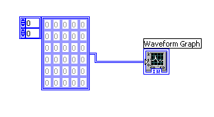

Hi harika,
I tried something for you.
Message 6 of 14
(3,996 Views)
Using tab control
Message 7 of 14
(3,991 Views)

Message 9 of 14
(3,978 Views)
