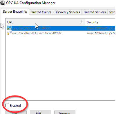

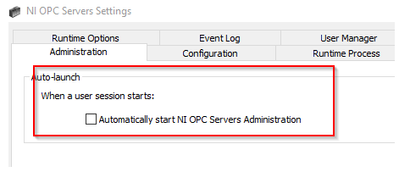

I think I've found a solution to that.  I've first disable the 'Auto-Launch' of the NI OPC Server Administration in the NI OPC Servers Settings.  Then in 'OPC UA Configuration Manager' in the 'Server Endpoints' tab I've duncheck the 'Enable' checkbox.  After that I was able to restart the PC without having the 'demo mode' turning on.
