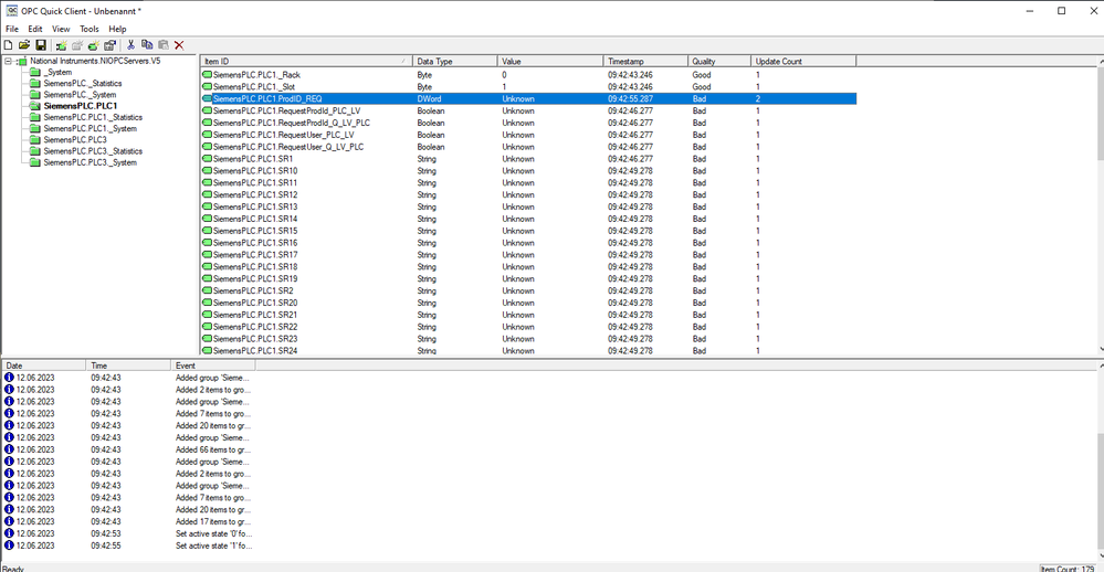

I get significant problem to establish the connection between LabVIEW and the PLC's via OPC when i start/boot the systems in the wrong order...
So when i first start the PLC1 and PLC2, wait for them till they are running and then start the PC with my NI OPC Software (which is autobooting) then the connection establishes and my LabVIEW application works totally fine with my configured PLC Tags and so on.
Anyway, I get a huge problem when i first start the PC with NI OPC Server and start the PLC's or basically plug-in the ethernet cable afterwards....
In that case connection doesn't establish.. it tells me in the NI OPC Quick Client that the "Quality" of the configured PLC Tags is bad.. (so basically it can't read them and in the System DB the error bit is true... so far so good.
Bad Tags after wrong Boot OrderBad Tags after wrong Boot Order
The main problem from now on is, that it is extremely complicated to get out of this error state to get the connection established again.

I was able to narrow my problem down.
It just occurs when im using a VM and run the "NI OPC Servers 2016".
On my usual Windows it works perfectly fine. (tested plug-off of cable and "wrong" boot order)
It always "finds" the Varaible Tags (Quality = Good) and the error bit always resets to 0.
I didnt examine the behaviour on the VM any further but it has somehow to do with the assignment of the IP adresses when the VM starts or when "Eternet Bridge" from my OS to the simulated VM OS is assigned.
Greetings,
DRobin
