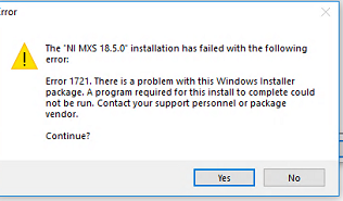

I have reoccuring problems installing various versions of DAQmx 18.5, 18.6, 19 etc, I always end up with this error message at some instance,
stopping and destroying the installation. What is this for hopeless installation system, and how can I solve this ?

Several people (including me) have had trouble installing the most recent versions of LabVIEW.  In my experience, once it "goes awry", you need to first uninstall all NI Software from your PC (instructions for how to do this safely can be found on the Web and on this Forum), and then start carefully and slowly to install the version(s) of LabVIEW that you want to run.
My recommendations for installation include:
  • Install the minimum that you need.  If you don't need multiple versions, install only one.  It is sometimes easier to install older versions than the most recent.
  • Download the latest Installer from the NI Download site (even if you already have one -- they keep updating them).
  • Install 32-bit LabVIEW unless you need 64-bit.
  • Install LabVIEW (by itself) first, reboot, install the minimum set of Toolkits and Modules you need, reboot, install Drivers.  If you don't need it, don't install it.

Please let me introduce my case.
In my case, I tried VeriStand 2018 SP1 on Windows 10 (1703 version), but failed with the error message as following.
  - The 'NI MXS 18.5.0' installation has failed with the following error:
    Error 1722. There is a problem with this Windows Installer package. ...
This problem is because of that Windows service 'Windows Installer' is not started, so you should start this service.
  - Windows Start button - Type 'services.msc' and Enter - Find 'Windows Installer' and Start.
This might not fit your case, but I hope this will be helpful to someone.
