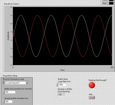

I have AO0 connected to AI0 and AO1 connected to AI1
one output is a cosine function and the other a sine
I am trying to utilize the NI device buffer to acquire/store data
i can increase the buffer read time so that the buffer should fill and start overwriting the first value but i see 150 samples in my buffer of 100 size and the chart doesn't indicate any overwritten or missed data.
The AvailSampPerChan seems to reset when the read occurs

The most unclear to me is the image example. buffer size is set to 100 but I read 1.5 seconds so 150 values, well over the buffer size.
I even slowed it down and see 4 times the buffer size with no sign of corruption/overwritten data
Maybe you should read this
There are commands to explicitly set the buffer size, but you are not using them. For continuous acquisition I never wire the number of samples in the timing mode. I also always use the buffer VIs to set the buffer size. Look in the DAQmx palette for them. (No LabVIEW on this computer.)

Here's a key idea for your learning:  with continuous sampling, DAQmx treats the buffer as though it's circular.  When it gets to the end, it starts right over again at the beginning.
Once you start a continuous sampling task, the driver is doing most of the dirty work for you in the background, continuously pushing data into the software task buffer in a circular fashion.  However, it also keeps track of which data your app has pulled from the buffer with calls to DAQmx Read.  So it knows if it's about to write over top of previous data that you haven't pulled out yet - in which case it throws an error.
Your job as a programmer is to keep calling DAQmx Read to pull data out of the buffer at a rate that, on average, keeps up with the rate that the driver pushes it in, which in turn is trying to keep up with the rate that the device is sampling.
Typically, the driver works at a very low level with minimal overhead, so it pushes small chunks of data into the buffer very frequently.  DAQmx Read works up at the app level where there's more overhead associated with each read, so it tends to work more reliably to pull decent-sized chunks of data from the buffer less frequently.  A very useful rule of thumb is to pull out 0.1 sec worth of data per read -- DAQmx can typically support a very wide range of sample rates when you follow this rule.
