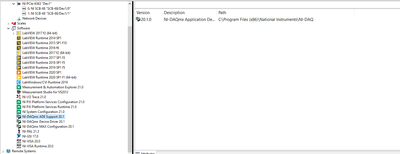

I wanna using the LabView 2017 for my program with NI-DAQmx. But whenever I installed and reboot my computer, the Labview show the warning: "NI-DAQmx Driver support for LabVIEW 2017 is missing and is referenced by the following VIs:"
When I check NI-MAX I see that my Labview is 64-bit but all of the NI-DAQmx was installed on Program(x86) folder it means NIDAQmx is 32-bit.
I tried to install a lot of versions but did not get any differences. My NI-MAX picture is attached.
Can anyone help me please ?

Run the NI-DAQmx installer again and make sure you install "Support for LabVIEW 2017 (64-bit)".

I installed by NI Package Manager and I didn't see any options like that.

Which version of DAQmx did you install? It must be at least 17.0 and at latest 20.7 to install proper support for LabVIEW 2017.

In  NI Package Manager, DAQmx 17 is only 32-bit.
If you need 64-bit version from NI Package manager, you need something like 18.5 and up to 20.7.

I am installing NI-DAQmx 20.1
But the driver was installed as 32 bit in Program(x86).
And this is my NI Package Manager looks like:
Please help me 😞

NI-DAQmx is a complex beast. The fact that supporting documents are installed in Program Files (x86) doesn't mean that it does not install the 64-bit driver components.
You have following parts that must get installed for DAQmx to work for your LabVIEW system:
- in <labview>\vi.lib\DAQmx, support VIs to access the DAQmx functionality. Each LabVIEW version that wants to use DAQmx needs to have these installed.
- in Windows\System32 a fairly large number of ni**.dll files that are the DAQmx driver and its device driver support files for 64-bit applications
- in Windows\SysWOW64 a similar amount of the same ni**.dll files that are the DAQmx driver and its support files for 32-bit applications.

Hi rolfk
in <labview>\vi.lib\, I don't see DAQmx folder.
Can you please show me how to set up my system in the correct way ?

Hi rolfk
I check Windows/System32 and Windows/SysWO64
They are having the ni*.dll files.
But when I try to install NI-DAQ, there are no DAQmx in the <vi.lib> file.
