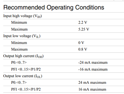

The digital TTL is always 0 to 5V. From NI 6351 Device Specifications,
Either you use the analog edge trigger, or you use an external circuit to invert the voltage.

Think of an analog signal as a "real" (or "float") quantity, and a digital signal as a Boolean (on = 5V, off = 0V).
To trigger on a negative (0V, -5V) signal, do you want to trigger on the rising edge (from -5V to 0) or the falling edge (from 0 to -5V)?  For the former, add 5V to you trigger line (to convert it to a TTL signal, triggering on the rising edge), and for the latter, simply invert the signal.  A simple op-amp circuit should handle either of these cases.
