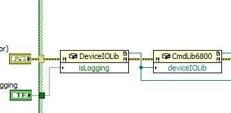

Inside the VI is a series of method calls that set everything up and ultimately return an array of strings with the Device Keys of the discovered instruments. I want to call your attention to the two teal-coloured lines coming out of these constructors, which is how everything starts. These are references to a DeviceIOLib object and a CmdLib6800 object. Is that correct? I am going to go with that nomenclature for now.

Error 1172 occurred at Error calling method [REDACTED].CmdLib6800.GetOutputEnable, (System.ArgumentNullException: Key cannot be null.
Parameter name: key)

I would suspect that your bug is something like calling your cases in the wrong order, or calling some other case that overwrites the variable with a null reference.  There is no reason why shift registers or local variables wouldn't work in passing a reference.

  • The error 1172 you are getting is just LabVIEW's way of wrapping around every .Net Exception that gets thrown - but if the object is a null reference you do get a different error (LV knows the difference). The source component of the error cluster is a little annoying I agree - it only takes out some of the Exception components and doesn't expose others (such as the stack-trace for example) that could allow you to dig into what is throwing the exception in this case. There is an idea exchange somewhere around this topic - feel free to up-vote it.
  • There is nothing wrong with using .Net object references as you describe (from a strategy perspective). I do it all the time, although I recommend not using local variables, of course.
  • Based on your error I'm in agreement with other comments made here - the error is likely a logical one rather then anything specificalyl .Net.
  • LabVIEW pins .Net objects in memory while they are in use and un-pins them (to allow the GC to operate) when they are no longer referenced - ie. the wire ends or you wire a null reference. It's fairly easy to do - just right-click on the shift register going out of your state machine and create a new constant.

Thank you, tyk007 and Yamaeda. The error indeed turned out not to be related to my use of local variables with object references. It was due to the fact that I was using a Device_Write method for a couple of hand-crafted instructions (instead of the pre-packaged instruction VIs) when I should have been using Device_Query. As a result, the instrument and the controlling library were getting out of sync (I wasn't clearing the output buffer with a read following my write), and the method call for subsequent query commands would throw an error when the library didn't get the type of response it was expecting ('OK' instead of a number, for example). I figured this out with help from the original instrument VI developer, suggesting I check the log file that this library can optionally create.
