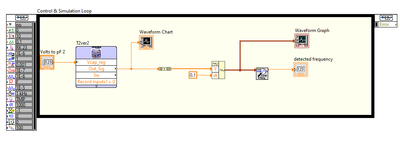

I created a simulation in Multisim. A stable square wave oscillator, with a opamp and a condenser and Resistance, more or less.
In multisim simulation, it works good. I have a good square wave in osciloscope.
iIn Labview 2019, through the Simulation -> External Models -> Multisim -> multisimDesign tool, i have imported this design do block diagram of labview.
I placed it inside a simulation cycle.
The problem is that I can't get the frequency of the square wave generated in the multisim, through the Tone tool.
I can only visualize it in the waveform Graph.
My question is how can I get a numerical indicator that tells me what is the frequency of the signal generated in the multisim simulation?
I already understand that the multisim sends only one signal to Labview, the amplitude.
How can i use Tone or another tool to know the frequency of the sinal from multisim Design ?
The Tone frequency must be the same or near of teoric frequency....

Thanks.
My problem is that -  multisim sends only the amplitude value to Labview. Dont send time's vetor, you know.
Labview cannot plot the signal, because it faults teime's vector.
. I can't get a square wave from the multisim simulation.
Using an extract tone, it can't get the frequency of the signal coming from the multisim.

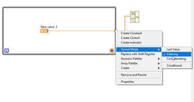

Heya,
I'm not a Multisim guy so I'm not sure what Multisim outputs in this scenario. Are you able to export the time characteristics at all, or just give a constant dt if the waveform has this?
Regarding the loop in the image below - it looks like you're overwriting your Y value in every loop iteration. If you want a live frequency analysis, you'll want to keep your previous Y value but add the new value to the array:
Otherwise, if you want to analyse at the end, build your array at the end of the loop:

Good afternoon.
Thank you for your kindness.
I am using a "Control & Simulation Loop", because I call the simulation of a module "Multisim", and in a normal loop this is not possible.
My problem is the Extract Tone doesnt read the real frequency. I tried to change the dt values ​​from 1E-7 to 10, and the problem remains. With dt = 1E-6, for example, it reads around 480 KHz. The realy value is around 1.3 KHz to 12 KHz. ( Varying the value in the selector, which gives 1 pf / Volt).
Please, i send you here the files Multisim and Labview. Would you to try it, please ?
I dont know what more to do...
Ty
hanks
Best regards.

Hi Cmc,
@CmcOlivares wrote:
I leave my solution less here, because we can all learn and teach !!
Please replace ALL local variables inside this loop by wires!
(Even in a Simulation loop the basic DATAFLOW rules apply!)
