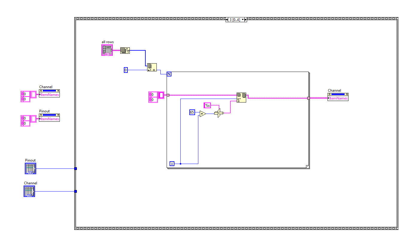

i have to create an index from A to ... in a multicolumn listbox related to the number of row from an other multicolumn listbox (). I have write this code but it not work, I don't understand why the for loop is executed only one time.... Thanks

Your array constant that you've wired in there is only size 1x1 and For loops iterate the lowest number of times that they can. So your N might be 3, but it will only loop once because your auto-indexed array only has 1 value to index through.
Just do this:

Thanks for the reply, sorry but i didn't understand very well .... is my first time with labview after many year.
I have change the code for a better implementation but i have a problem to create an array of string, i don't understand the component that you have used in the solution proposed. I attached the new software.

Ok, i have found the solution. If i connect the two components in the image i obtain an error, pressing the right button of the mouse and selecting built array i have solved!!

If you have LabVIEW 2014 or newer, you can drag the image (snippet) that I included above directly to your block diagram, FYI.
