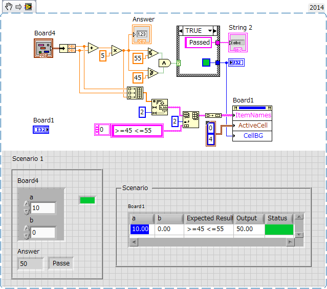

Please I am trying to get my Scenario1 to Scenario2 whereby I have the background colour of my output change to either red(fail) or green(pass) based on my answer.
Also would it be possible to have another column that shows staus of either a pass or fail?

First select the cell by ”Active Cell”. Then you will specify the color of the cell with "CellBG".
(3,979 Views)
Thanks Kondoh.
I have edited it to change the backgrnd colour behind the "output text"

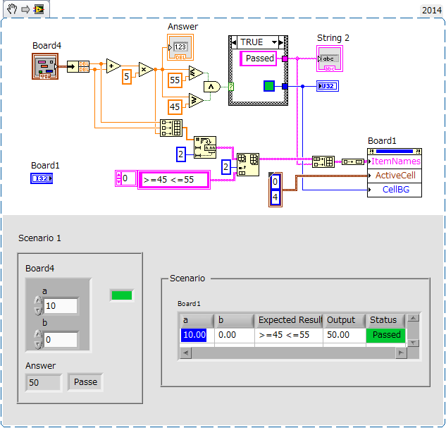

What i'm wondering now is if I can get the text PASS/FAIL to be displayed under "Status"
(3,973 Views)
Display PASS/FAIL under "Status"
(3,963 Views)
